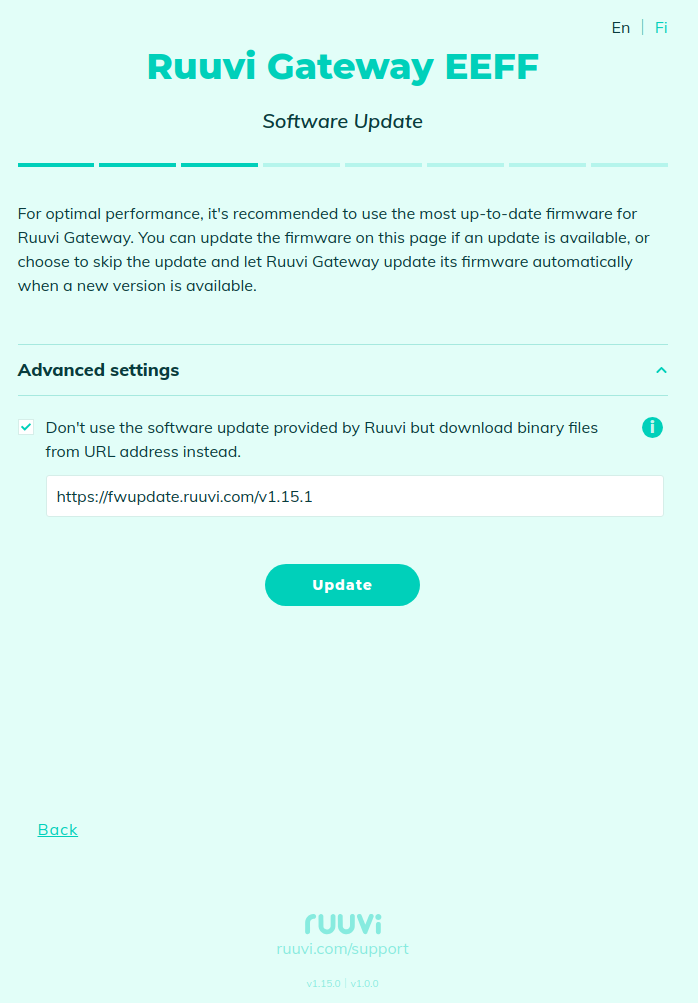

Open Web-UI, go to "Software Update" page, expand "Advanced Settings" and enable the checkbox "Don't use the software update provided by Ruuvi but download binary files from URL address instead":
<figure><img src="https://1423309131-files.gitbook.io/~/files/v0/b/gitbook-x-prod.appspot.com/o/spaces%2F-LsPjfnhNj3v37AZtF-d%2Fuploads%2Fgit-blob-ec5e97a9c155be8479f501dad569e926b8b589ed%2FScreenshot%20from%202023-12-13%2009-36-05.png?alt=media" alt=""><figcaption></figcaption></figure>
In the URL input field change the version number to the desired one, then press "UPDATE" button.

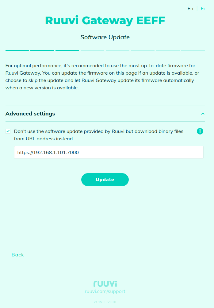

Then open Web-UI, go to "Software Update" page, expand "Advanced Settings", enable checkbox "Don't use the software update provided by Ruuvi but download binary files from URL address instead" and in the URL input field set the address of your local HTTP server, then press "UPDATE" button:
