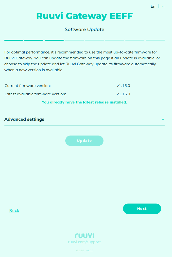

In this step, Ruuvi Gateway checks for software updates.
<figure><img src="https://1423309131-files.gitbook.io/~/files/v0/b/gitbook-x-prod.appspot.com/o/spaces%2F-LsPjfnhNj3v37AZtF-d%2Fuploads%2Fgit-blob-e75f9a59766d021db21972914486e2c2b6758361%2FScreenshot%20from%202023-12-12%2023-58-31.png?alt=media" alt=""><figcaption></figcaption></figure>

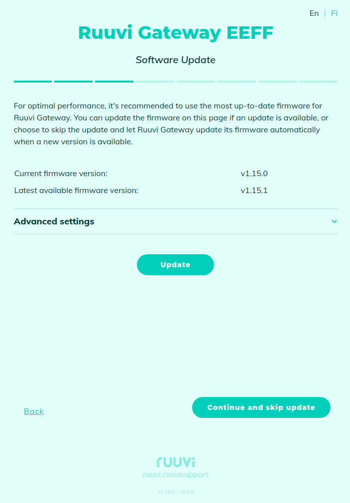

If a newer version is available, the gateway will offer to update the firmware:
<figure><img src="https://1423309131-files.gitbook.io/~/files/v0/b/gitbook-x-prod.appspot.com/o/spaces%2F-LsPjfnhNj3v37AZtF-d%2Fuploads%2Fgit-blob-09f5addfe453c918779df96b58d5c567112fddc7%2FScreenshot%20from%202023-12-19%2021-22-43.png?alt=media" alt=""><figcaption></figcaption></figure>

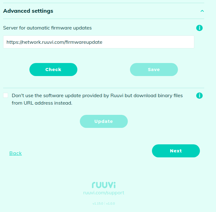

You can set up your own server for firmware updates, and you can configure it's address in the "**Advanced settings**" section:
<figure><img src="https://1423309131-files.gitbook.io/~/files/v0/b/gitbook-x-prod.appspot.com/o/spaces%2F-LsPjfnhNj3v37AZtF-d%2Fuploads%2Fgit-blob-94e0c70aae1050ae38a2faa284c4a202740f59bd%2FScreenshot%20from%202023-12-13%2000-01-36.png?alt=media" alt=""><figcaption></figcaption></figure>

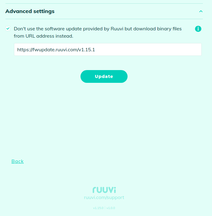

You can also install earlier or beta versions of the software by providing the URL to the required firmware. If you have built your own firmware, you can run HTTP server and provide the URL to your firmware binaries (See [GW Install custom firmware](https://docs.ruuvi.com/ruuvi-gateway-firmware/gw-install-custom-firmware.md)).
<figure><img src="https://1423309131-files.gitbook.io/~/files/v0/b/gitbook-x-prod.appspot.com/o/spaces%2F-LsPjfnhNj3v37AZtF-d%2Fuploads%2Fgit-blob-8cb64ba160dc917ffa8fc9771a640d8ed3d2eceb%2FScreenshot%20from%202023-12-13%2000-08-41.png?alt=media" alt=""><figcaption></figcaption></figure>

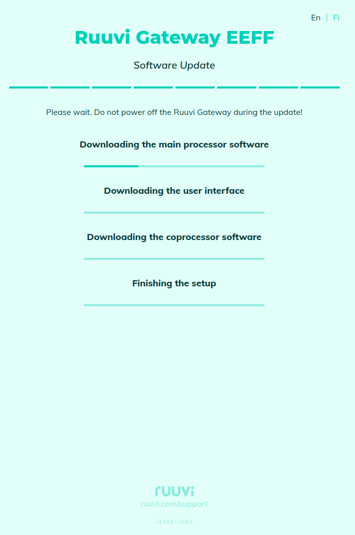

Here is an example of the software update process:
<figure><img src="https://1423309131-files.gitbook.io/~/files/v0/b/gitbook-x-prod.appspot.com/o/spaces%2F-LsPjfnhNj3v37AZtF-d%2Fuploads%2Fgit-blob-58c0f71de0a09b483be63643a21b4d769a87ee8c%2FScreenshot%20from%202023-12-13%2000-09-28.png?alt=media" alt=""><figcaption></figcaption></figure>

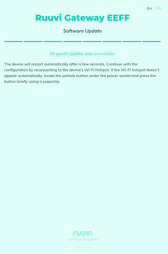

After the software update is completed, Ruuvi Gateway will be restarted in a few seconds, and the following page will be displayed:
<figure><img src="https://1423309131-files.gitbook.io/~/files/v0/b/gitbook-x-prod.appspot.com/o/spaces%2F-LsPjfnhNj3v37AZtF-d%2Fuploads%2Fgit-blob-f696661965b4fd1673d91cfb972a60ab4dae0f17%2FScreenshot%20from%202023-12-13%2000-09-54.png?alt=media" alt=""><figcaption></figcaption></figure>
