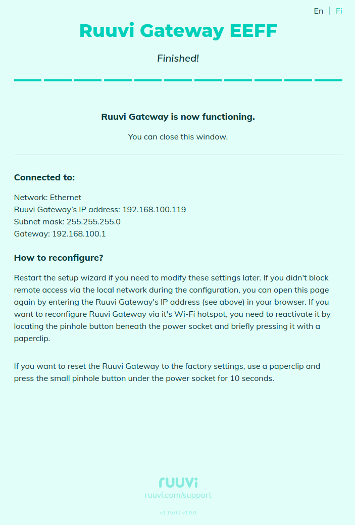

Once the configuration is complete, the following page will be displayed, where you can see the IP address assigned to the Ruuvi Gateway in the local network:
<figure><img src="https://1423309131-files.gitbook.io/~/files/v0/b/gitbook-x-prod.appspot.com/o/spaces%2F-LsPjfnhNj3v37AZtF-d%2Fuploads%2Fgit-blob-0f98b8917971125e0bf53b24c8b7a4e64eeb5e6d%2FScreenshot%20from%202023-12-19%2021-55-07.png?alt=media" alt=""><figcaption></figcaption></figure>
