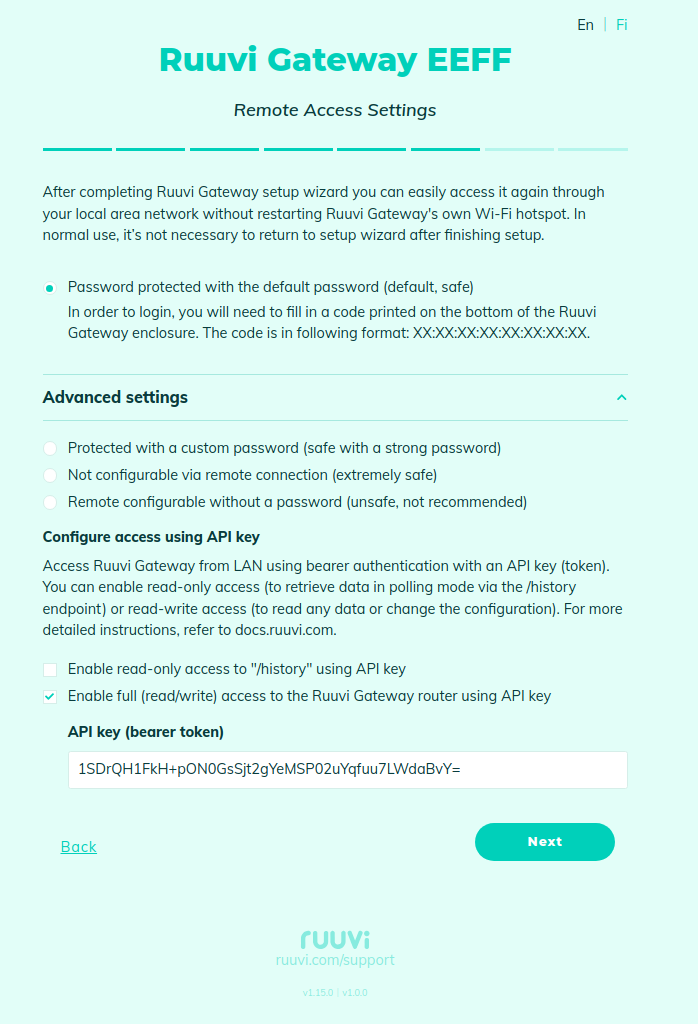

If your Gateway is password protected, you can configure the Gateway to allow you to update the configuration on it programmatically using bearer authentication.
On the "Access Settings" page, enable full access using bearer authentication and set the API-key:
<figure><img src="https://1423309131-files.gitbook.io/~/files/v0/b/gitbook-x-prod.appspot.com/o/spaces%2F-LsPjfnhNj3v37AZtF-d%2Fuploads%2Fgit-blob-5e86acb5475cb225d716e1e2e104e9f496ed7f58%2FScreenshot%20from%202023-12-13%2010-20-48.png?alt=media" alt=""><figcaption></figcaption></figure>
