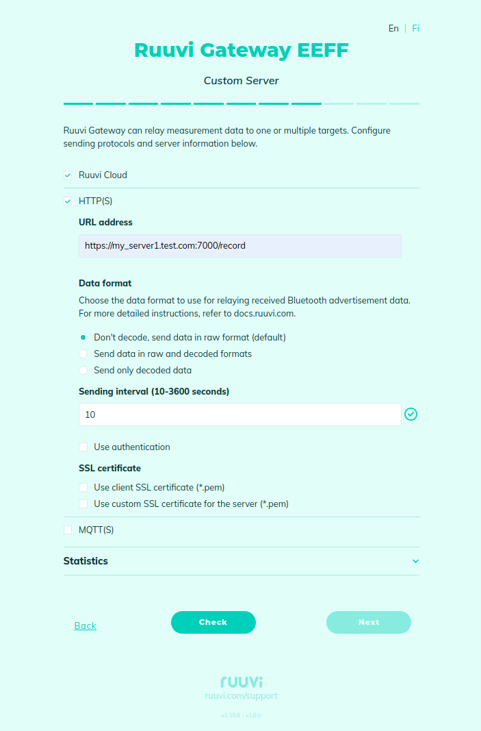

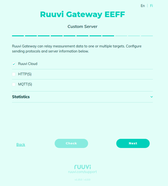

You can enable or disable sending data to Ruuvi Cloud:
<figure><img src="https://1423309131-files.gitbook.io/~/files/v0/b/gitbook-x-prod.appspot.com/o/spaces%2F-LsPjfnhNj3v37AZtF-d%2Fuploads%2Fgit-blob-3a65d80674d8857efeeb6302817dd8c25e765843%2FScreenshot%20from%202023-12-13%2008-56-59.png?alt=media" alt=""><figcaption></figcaption></figure>

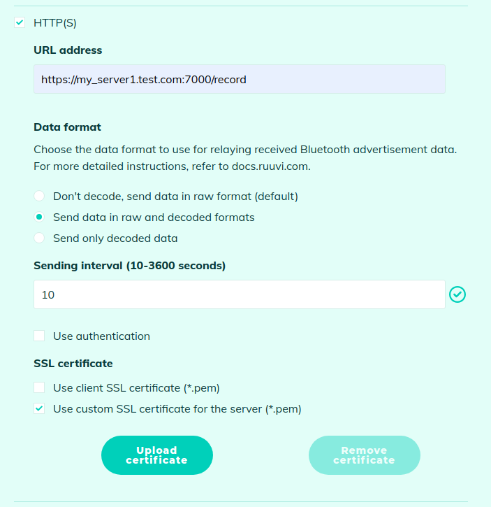

Or configure to send data to your own server via HTTP/HTTPS (it is possible to send data to both destinations, Ruuvi Cloud and your own server, at the same time):
<figure><img src="https://1423309131-files.gitbook.io/~/files/v0/b/gitbook-x-prod.appspot.com/o/spaces%2F-LsPjfnhNj3v37AZtF-d%2Fuploads%2Fgit-blob-f91825c0d2b7b3cb395df3ff6562ae4b8c175136%2FScreenshot%20from%202023-12-19%2021-32-09.png?alt=media" alt=""><figcaption></figcaption></figure>

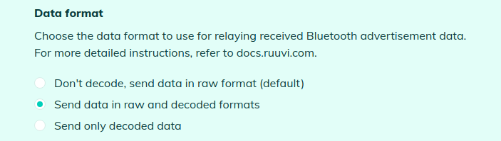

For your own server, you can choose the data format and decode data from Ruuvi sensors on the Gateway side:
<figure><img src="https://1423309131-files.gitbook.io/~/files/v0/b/gitbook-x-prod.appspot.com/o/spaces%2F-LsPjfnhNj3v37AZtF-d%2Fuploads%2Fgit-blob-c981e8281de4ff5da6cd2858f5985bb3f5b9763a%2FScreenshot%20from%202023-12-19%2021-32-54.png?alt=media" alt=""><figcaption></figcaption></figure>

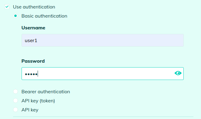

#### Configuring Basic Authentication
When using "Basic" authentication, the gateway adds an authorization header to the HTTPS request. This header contains the credentials encoded in Base64 format.
<figure><img src="https://1423309131-files.gitbook.io/~/files/v0/b/gitbook-x-prod.appspot.com/o/spaces%2F-LsPjfnhNj3v37AZtF-d%2Fuploads%2Fgit-blob-9ced5caf5ae8a04b48d07503513920cc010cfe59%2FScreenshot%20from%202024-05-08%2015-45-19.png?alt=media" alt=""><figcaption></figcaption></figure>
HTTP Header Example:\
`Authorization: Basic dXNlcjE6cGFzczE=`
Explanation:
* `Basic`: Indicates the authentication method.
* `dXNlcjE6cGFzczE=`: Base64 encoded credentials. For example, 'user1:pass1' encodes to 'dXNlcjE6cGFzczE='.

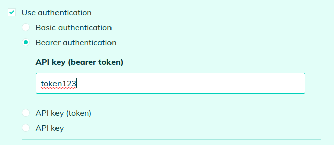

When using "Bearer" authentication, the gateway adds an authorization header with a token to the HTTPS request. This token is a credential used to access APIs securely.
<figure><img src="https://1423309131-files.gitbook.io/~/files/v0/b/gitbook-x-prod.appspot.com/o/spaces%2F-LsPjfnhNj3v37AZtF-d%2Fuploads%2Fgit-blob-2e9fe7da681bde6c9780708d59f5ac911728f138%2FScreenshot%20from%202024-05-08%2015-46-10.png?alt=media" alt=""><figcaption></figcaption></figure>
`Authorization: Bearer token123`

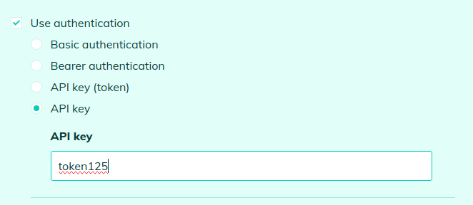

#### Configuring API Key Authentication

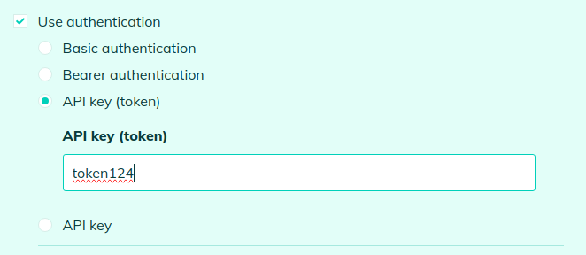

API key authentication is a simple method where an API key is used directly as part of the HTTP header to authenticate requests.
<figure><img src="https://1423309131-files.gitbook.io/~/files/v0/b/gitbook-x-prod.appspot.com/o/spaces%2F-LsPjfnhNj3v37AZtF-d%2Fuploads%2Fgit-blob-4980619ebf4a9882bf734a1e507098a9dfdd0375%2FScreenshot%20from%202024-05-08%2015-46-57.png?alt=media" alt=""><figcaption></figcaption></figure>
`Authorization: token125`

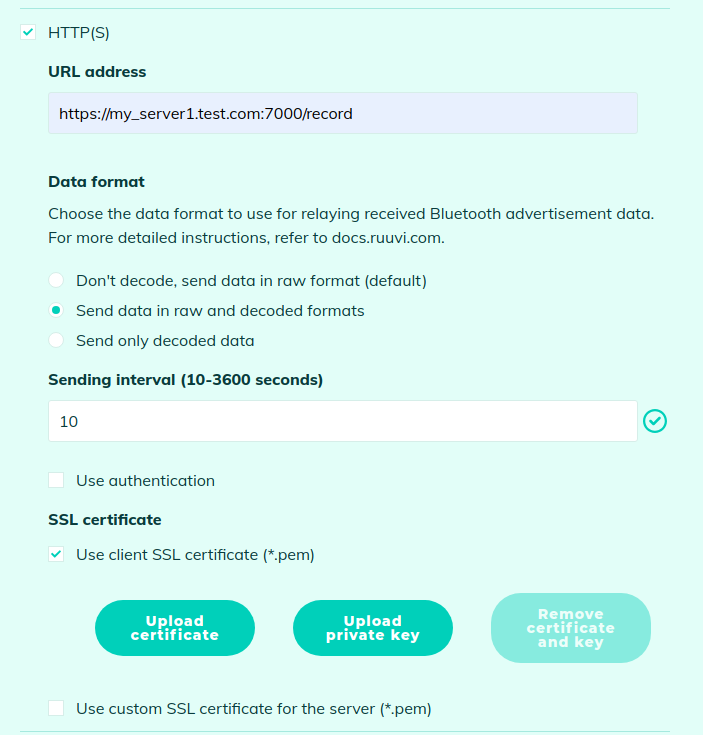

#### Enhanced Security with SSL Client Authentication
It also supports client authentication via SSL by enabling the upload of a client certificate and its associated private key, ensuring secure and verified client-server communication:
<figure><img src="https://1423309131-files.gitbook.io/~/files/v0/b/gitbook-x-prod.appspot.com/o/spaces%2F-LsPjfnhNj3v37AZtF-d%2Fuploads%2Fgit-blob-7659bf0802fcdae292aa6c3b0bbed1892c0f9177%2FScreenshot%20from%202023-12-19%2021-33-50.png?alt=media" alt=""><figcaption></figcaption></figure>
