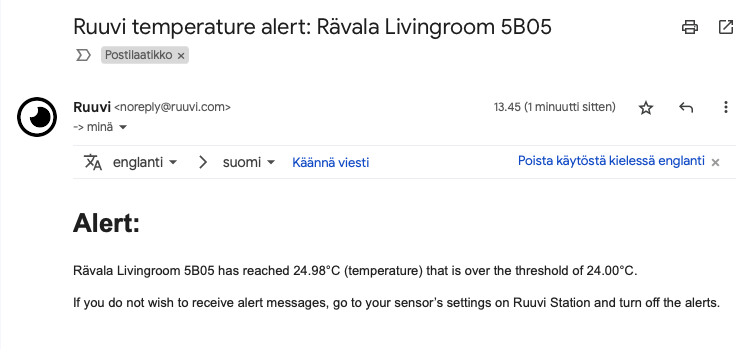

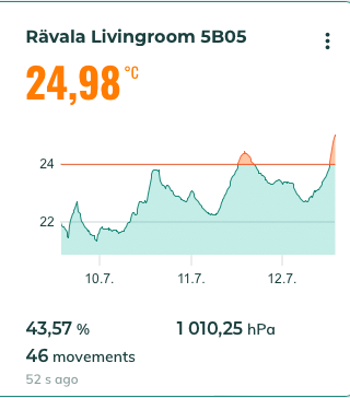

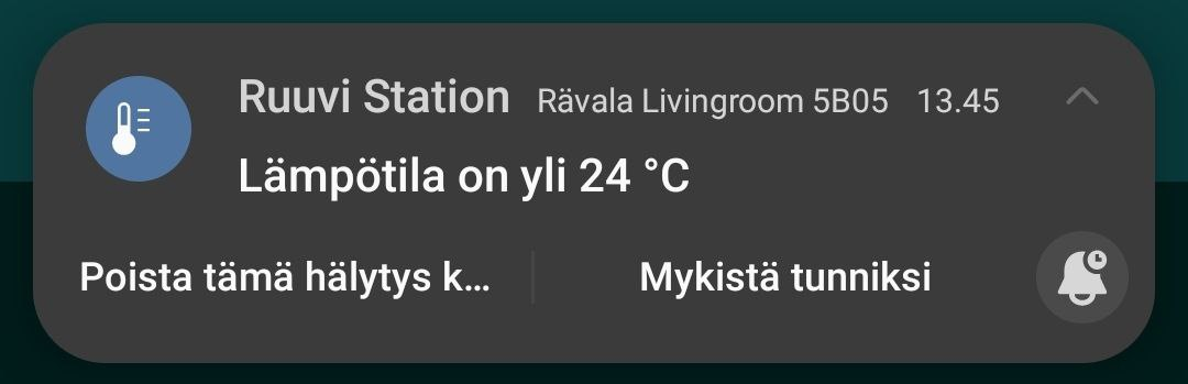

The alerts can be received as UI icon in apps or station.ruuvi.com dashboard, through push notification in mobile apps and emails.
<div align="left"><figure><img src="https://1423309131-files.gitbook.io/~/files/v0/b/gitbook-x-prod.appspot.com/o/spaces%2F-LsPjfnhNj3v37AZtF-d%2Fuploads%2Fgit-blob-5d84b8d0d2b7e18602d688d29475fd0aa571bb23%2FN%C3%A4ytt%C3%B6kuva%202023-7-12%20kello%2013.43.02.png?alt=media" alt="" width="160"><figcaption><p>UI Notification</p></figcaption></figure></div>
<div align="left"><figure><img src="https://1423309131-files.gitbook.io/~/files/v0/b/gitbook-x-prod.appspot.com/o/spaces%2F-LsPjfnhNj3v37AZtF-d%2Fuploads%2Fgit-blob-2346b42e42a7296124555d3bc83c1c1ab2dc1308%2Fimage.png?alt=media" alt="" width="375"><figcaption><p>Push notification</p></figcaption></figure></div>
<div align="left"><figure><img src="https://1423309131-files.gitbook.io/~/files/v0/b/gitbook-x-prod.appspot.com/o/spaces%2F-LsPjfnhNj3v37AZtF-d%2Fuploads%2Fgit-blob-ba492bd4f818945ccfedb10e74ea82d52707bd21%2FN%C3%A4ytt%C3%B6kuva%202023-7-12%20kello%2013.47.00.png?alt=media" alt="" width="375"><figcaption><p>Email alert</p></figcaption></figure></div>

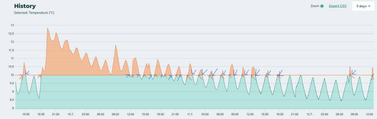

Alerts trigger once and wait until they are resolved before they can be triggered again. However, reconfiguring an alert such as adjusting alert trigger limits or disabling and re-enabling it will always resolve alert, which leads to a new trigger if the alert condition remains after reconfigruration. Image below shows trigger-events with red arrow and resolve-events with blue arrow.
Additionally, alerts can trigger at most once per hour for user and alert per sensor, this reduces spam in case where e.g. fridge swings back and forth the alert thresholds. Business users can configure delay before triggering an alert for e.g. walk-in freezers which might spike up for a short while when someone enters and then drop back to allowed range.
<figure><img src="https://1423309131-files.gitbook.io/~/files/v0/b/gitbook-x-prod.appspot.com/o/spaces%2F-LsPjfnhNj3v37AZtF-d%2Fuploads%2Fgit-blob-2df0e689c71bd5507379080bd650445cb252ef76%2Falert%20trigger%20resolve.png?alt=media" alt=""><figcaption><p>Alert triggering and getting resolved</p></figcaption></figure>
