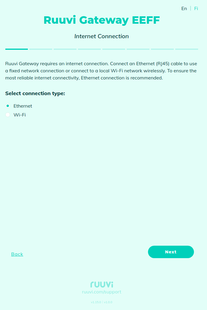

<figure><img src="https://1423309131-files.gitbook.io/~/files/v0/b/gitbook-x-prod.appspot.com/o/spaces%2F-LsPjfnhNj3v37AZtF-d%2Fuploads%2Fgit-blob-cada9cc256b6d7607a4156424687dc2bd4baadf6%2FScreenshot%20from%202023-12-12%2023-22-31.png?alt=media" alt=""><figcaption></figcaption></figure>

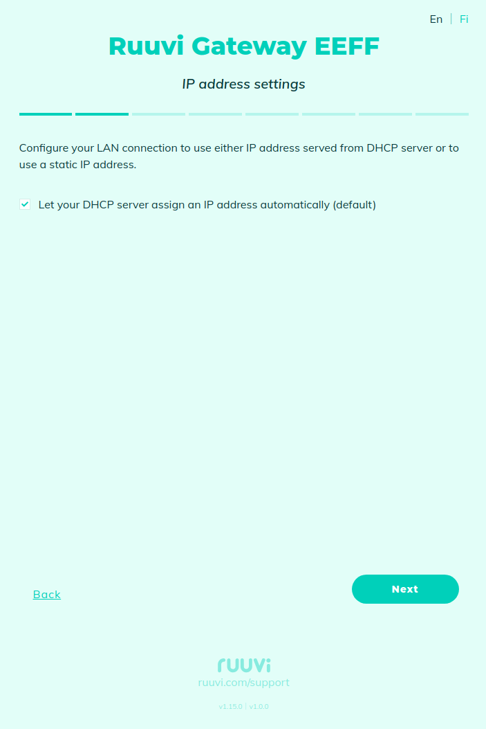

By default DHCP is enabled, so you don't need to configure anything else:
<figure><img src="https://1423309131-files.gitbook.io/~/files/v0/b/gitbook-x-prod.appspot.com/o/spaces%2F-LsPjfnhNj3v37AZtF-d%2Fuploads%2Fgit-blob-79b3717f8a8cd1ecf1212e3a15c310b1a93fa264%2FScreenshot%20from%202023-12-19%2021-27-49.png?alt=media" alt=""><figcaption></figcaption></figure>

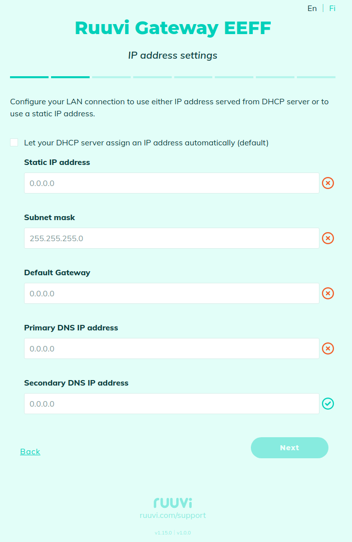

But you can always set the network settings manually, if necessary:
<figure><img src="https://1423309131-files.gitbook.io/~/files/v0/b/gitbook-x-prod.appspot.com/o/spaces%2F-LsPjfnhNj3v37AZtF-d%2Fuploads%2Fgit-blob-bc62d866174b0993c69356947fe6ca739151c498%2FScreenshot%20from%202023-12-19%2021-26-06.png?alt=media" alt=""><figcaption></figcaption></figure>

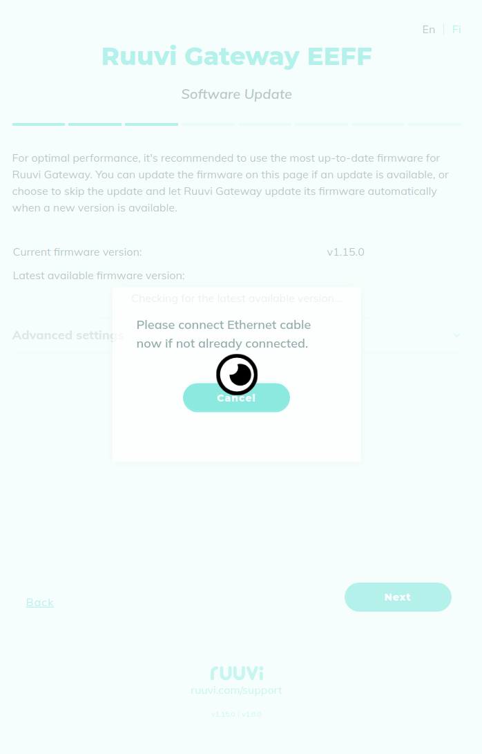

In the next step, Ruuvi Gateway will ask you to connect the Ethernet cable (but that's okay if it's already connected):
<figure><img src="https://1423309131-files.gitbook.io/~/files/v0/b/gitbook-x-prod.appspot.com/o/spaces%2F-LsPjfnhNj3v37AZtF-d%2Fuploads%2Fgit-blob-80506ea5c8bbe8acab12bd79b2868966b376a0b8%2FScreenshot%20from%202023-12-12%2023-24-33.png?alt=media" alt=""><figcaption></figcaption></figure>

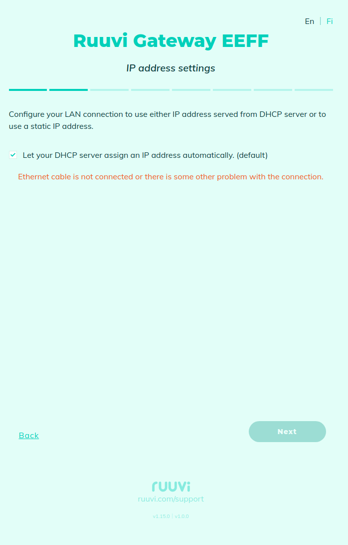

if the Ethernet cable has not been connected in 30 seconds, an error message will be displayed. In this case, you can go back and try again.
<figure><img src="https://1423309131-files.gitbook.io/~/files/v0/b/gitbook-x-prod.appspot.com/o/spaces%2F-LsPjfnhNj3v37AZtF-d%2Fuploads%2Fgit-blob-fa24445406075a36aab176650aaea9d5b73603fd%2FScreenshot%20from%202023-12-12%2023-27-05.png?alt=media" alt=""><figcaption></figcaption></figure>
