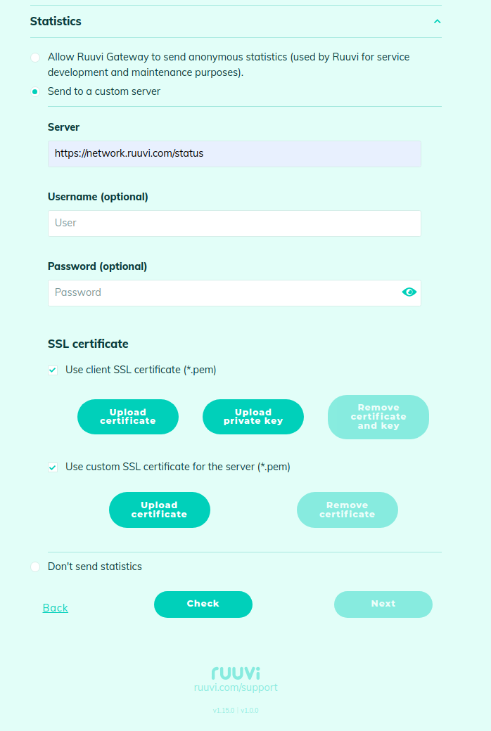

In the Statistics section, you can configure the sending of statistics to Ruuvi Cloud or your own server, or disable the sending of statistics:
<figure><img src="https://1423309131-files.gitbook.io/~/files/v0/b/gitbook-x-prod.appspot.com/o/spaces%2F-LsPjfnhNj3v37AZtF-d%2Fuploads%2Fgit-blob-6fc9f402d9fcec7498d99a2a9a9016091f92c7be%2FScreenshot%20from%202023-12-13%2009-18-42.png?alt=media" alt=""><figcaption></figcaption></figure>
When using your own server, you and use basic authentication and/or use client authentication via SSL by enabling the upload of a client certificate and its associated private key, ensuring secure and verified client-server communication. Also, you can use a server SSL Certificate if you want to be independent of public Certificate Authorities (CAs) or if you have deployed a self-signed certificate on the HTTPS server, giving you greater control and customization over your security infrastructure:
