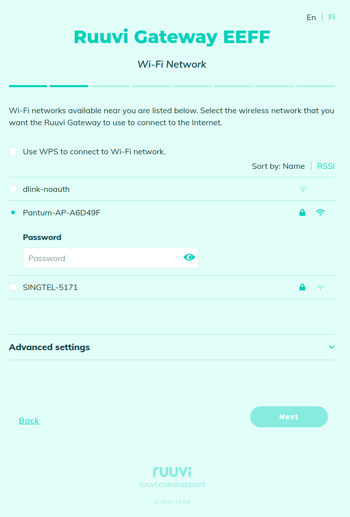

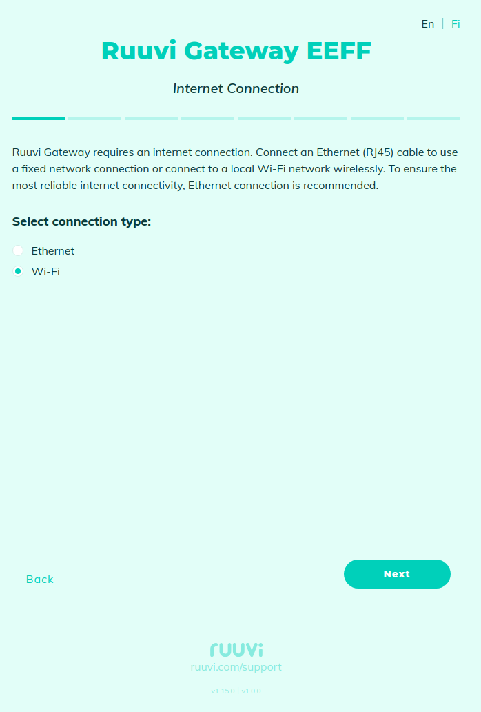

<figure><img src="https://1423309131-files.gitbook.io/~/files/v0/b/gitbook-x-prod.appspot.com/o/spaces%2F-LsPjfnhNj3v37AZtF-d%2Fuploads%2Fgit-blob-15112bc9d38ac660acd32ab6f873f0d31ad3f5fc%2FScreenshot%20from%202023-12-12%2022-26-21.png?alt=media" alt=""><figcaption></figcaption></figure>
Select the desired Wi-Fi and enter the password:
<figure><img src="https://1423309131-files.gitbook.io/~/files/v0/b/gitbook-x-prod.appspot.com/o/spaces%2F-LsPjfnhNj3v37AZtF-d%2Fuploads%2Fgit-blob-0c1fcba9fcd095a3b6fe3d0e66044c0e03c1c60a%2FScreenshot%20from%202023-12-12%2022-29-12.png?alt=media" alt=""><figcaption></figcaption></figure>

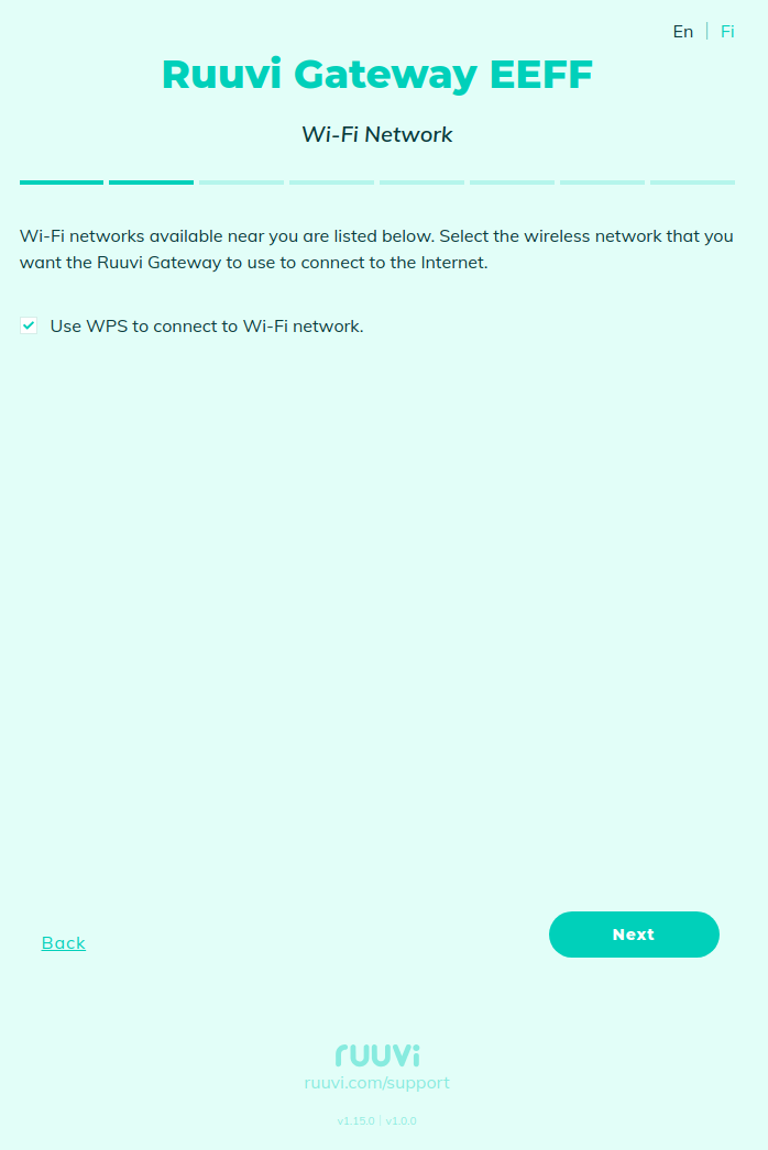

If your router supports WPS (Wi-Fi Protected Setup), you can connect to a Wi-Fi hotspot without entering a password. Enable the checkbox "**Use WPS to connect to Wi-Fi network**", press the "**Next**" button and then press the WPS button on your router.

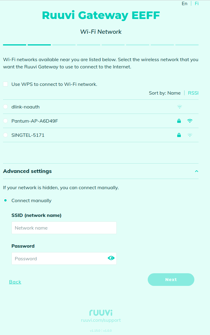

In case Wi-Fi is hidden, you can enter WiFi SSID manually - this option is available under "Advanced settings":
<figure><img src="https://1423309131-files.gitbook.io/~/files/v0/b/gitbook-x-prod.appspot.com/o/spaces%2F-LsPjfnhNj3v37AZtF-d%2Fuploads%2Fgit-blob-bb26385e9184da66d14527d8a4cce01f1b98e402%2FScreenshot%20from%202023-12-12%2022-30-26.png?alt=media" alt=""><figcaption></figcaption></figure>
