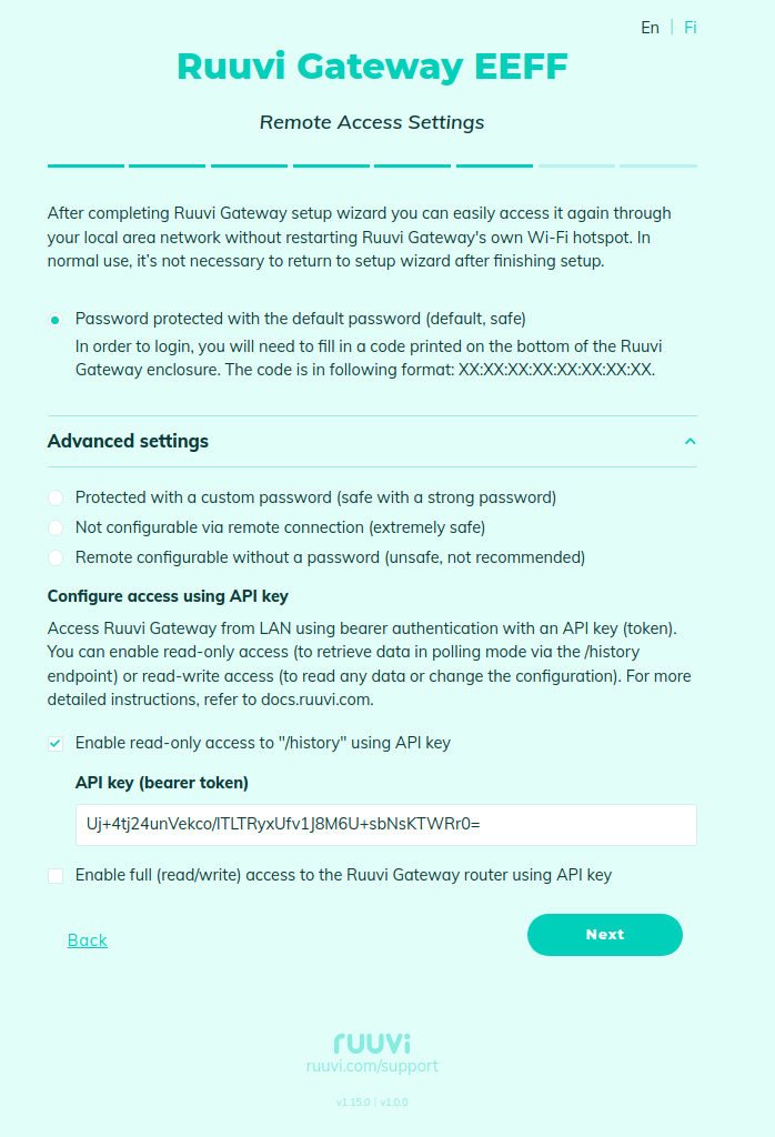

It is possible to poll the accumulated data from the Ruuvi Gateway via HTTP.
On the "Access Settings" page, enable bearer authentication and set the bearer token:
<figure><img src="https://1423309131-files.gitbook.io/~/files/v0/b/gitbook-x-prod.appspot.com/o/spaces%2F-LsPjfnhNj3v37AZtF-d%2Fuploads%2Fgit-blob-7da11293ef7b61e5cce718295f03d775ac59c29c%2FScreenshot%20from%202023-12-13%2010-19-16.png?alt=media" alt=""><figcaption></figcaption></figure>
After that it is possible to poll data using the "/history" endpoint:
